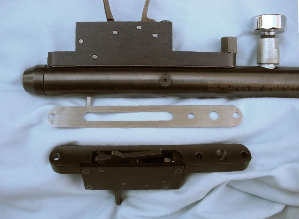

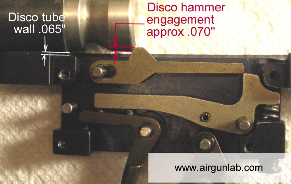

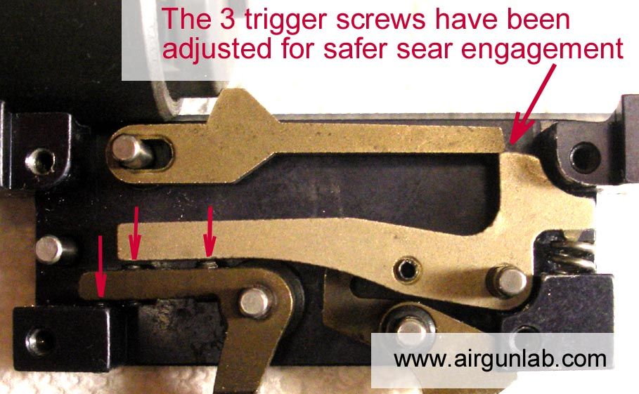

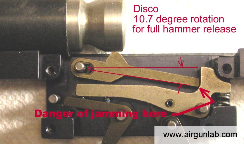

Bob, I was thinking more of a .032 thick shim between the trigger assy and the tube. I don't know if the sear is through hardened, or just case hardened, so grinding might or might not be an option. By using a shim, you could also later swap the trigger back to an M-rod if need be. Lloyd
