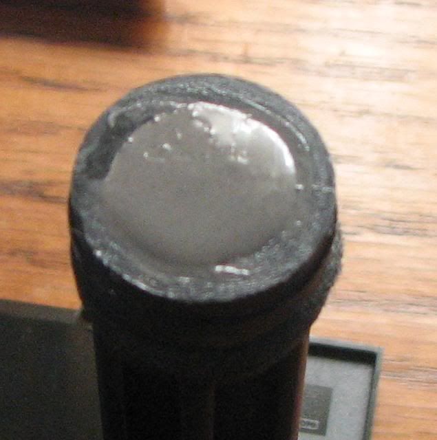

As some here already know, I have been milling over buying a Daisy 953. I just saw on the aigunone forum that the Avanti Lothar Walther barrel can be ordered from Daisy for $60 USD and is an easy swap job. The guy who posted the Aigunone thread also seems to have figured out a reliable power mod that will slightly increase the FPS. Anyone familiar with this, any downsides?

Yeah I've heard of this epoxy mod. Its supposed to give like 40 more fps.

I love my 953, so consistent and easy to shoot it is the gun that really turned me onto AGs. It still is my plinker of choice, I am interested in the epoxy mod for an additional 40FPS....

Just finished the epoxy mod and went from an average of 463 fps to 490 fps. I was conservative with the epoxy and filled the cavity just barely above flush and none overflowing on the rim.

There one post somewhere that drilling out the hole in front of the valve will increase fps also. I never tried it because I gave the 953 away to a friend. Did fill the piston with epoxy also but think if there is too much void filled it may put too much strain on the cocking pivot point. JMO
