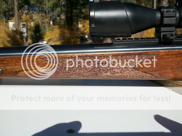

Well finally got around to finishing up the stock on my Ruger Air Mag. The checkering was a little messed up so I decided to try my hand at stippling. I used my Dremel with a diamond tip and a carbide cutter. Turned out pretty good for a first try. Did a quick buff up with 0000 steel wool then applied a couple coats of Tung Oil Finish. The stippling feels great in my hand and provides a real nice grip. Way more traction than the checkering ever had.
Have a look.

I would have loved a smooth stock on that but it wasn't an option. But now it really feels nice and the broken checkering is gone.

Thanks. Took about 4 hours total time.

Cool looking Mike.Im working on a Benji and am about half done just not much time this week.I think the stippled stocks are a bit easier to hold and grip compared to checkering.I use a Dremel and a high speed drill that dentist use.I also use carbon paper so if i have another gun with some really nice checkering design i put the carbon paper on the gun upside down and trace it to paper and then to gun im working on.Get some neat designs from some guns that way too! I always like seeing the pics or any ideas others have to check out as i always have room for improvement! Nice pics!

Thanks guys. I might go back into it and hit the whole surface at an greater angle to remove some of those more rounded spots. I need to get a better tip for it too. the carbide cutter really isn't suited for this work and the diamond grinder I have is too small. So I need a larger diameter diamond tip and need to replace my flex extension for my dremel or at least get a new core drive for it. It gave out half way through the first panel so I had to handle the bulky Dremel body for most of the work.
