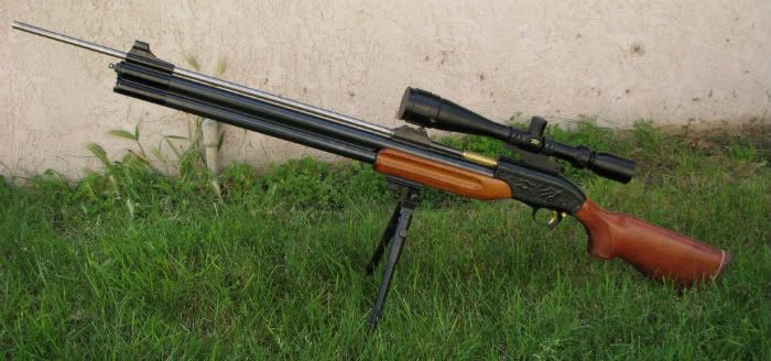

I did a barrel swap on my 201 . I sent the 357 barrel to Will at
http://saddlemountaingunsmith.com/
and he did all the modifactions needed to a TOW 25 caliber barrel liner . I then screwed the barrel back on with no other changes being done . I did the testing in doors at our 16 yard range because of the weather . The first two shoots through the barrel left one hole on the target . The remainder of the chrony work showed me that this rifle will do what my 25 condor will do at this range with the same bullets . So I have no dought that it will do what the condor does which is moa at 100 yards . It has more power than my condor and I will be teathering this rifle alot to a 80 cf tank . Happy yes I am . Thanks Will you did a excellent job for me again . He also made a barrel for my 909 which is now a 32 caliber and will be teathered as well . Here is a look at the rifle with a 28 inch 1 in 14 twist 25 barrel .
These are the two bullets that I casted my self using 12 bhn lead . The bullets are sized to .2495 .
Here are the regulated strings I ran today .Marvin
