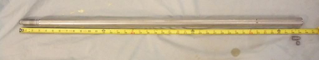

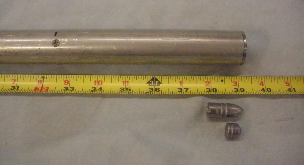

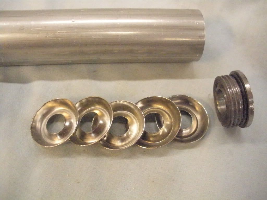

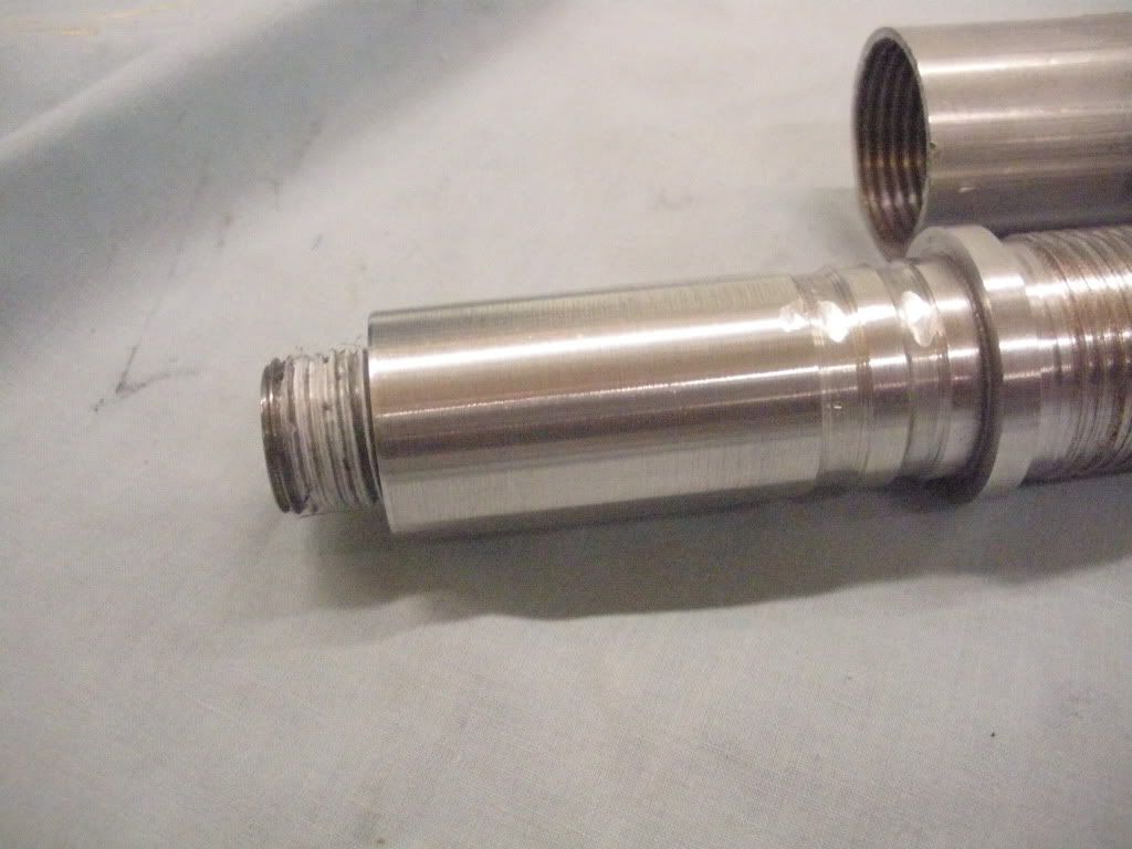

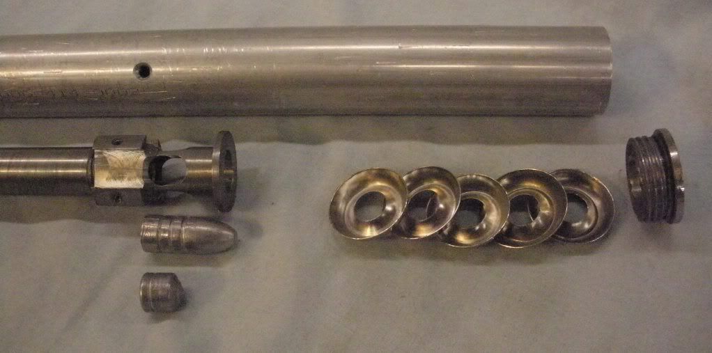

Here are some pics of the shroud. It's a big thing with a 32" long barrel, .510 cal. 33" of the shroud sticks out from the receiver. End cap and receiver adapter are threaded into the shroud tube which is 1.25 O.D. with .08 wall. Very stout. No blowing the end cap out of this one. The air stripper threaded onto the end of the muzzle has big openings to send the bulk of the excess air back toward the receiver. I want to stuff that section with some sound absorbing material. At the muzzle are several "decorative steel washers," to redirect the residual air and take away some of the energy.
I hope to get a video sometime soon of this thing in action.
Thanks,
Lloyd

Lloyd do you space the washers? Do you pack between them w/the Scotchbrite material?
Kentucky
lloyd-ss
Bob and Lloyd
Posts: 3571
Real Name: Lloyd
Re: Anybody tried stuffing the back end of a shroud (PICS ADDED)
May 11, 2011, 02:06:52 PM »
I don't have them in the picture, but I use a short piece (about .25 long ) of tubing between each washer to space them. I had to expand the O.D. of the washers to make them a force fit into the tube, then a tube spacer between each washer. After its all threaded together I force a .560 madrel thru the washers to do a final centering and sizing. Honestly, I haven't found anything that will stay put in the front end between the washers in the big-bore sizes, and that has led to a few..... uh, mishaps.
Those metal washers take a pretty severe hit from the air blast.
Lloyd
